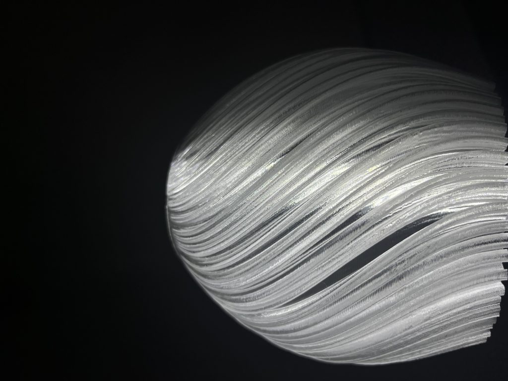

3D printing filament PETG also provides great light diffusion, making it the ideal material for anything where you plan to use LED lights in your project, whether it be a lamp shade or decorative light panels, for instance.
Lamp Shade, printed by Geeetech transparent PETG filament
