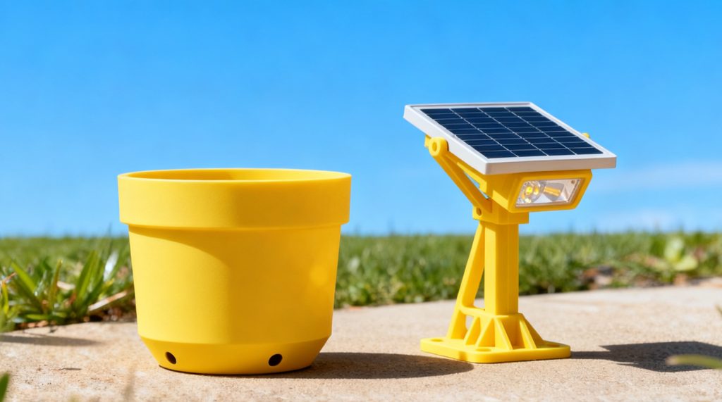

ASA printed the Mounting bracket and planter
ASA printed mounting bracket and planter
  • Planters
  • Irrigation parts
  • Tool handles
  • Exterior trim
  • License plate holders
  • Custom side mirrors
  • Electrical enclosures
  • Outdoor sensor casings
  • Mounting brackets for solar lights
  • Drone bodies
  • GoPro mounts
  • Outdoor signage
