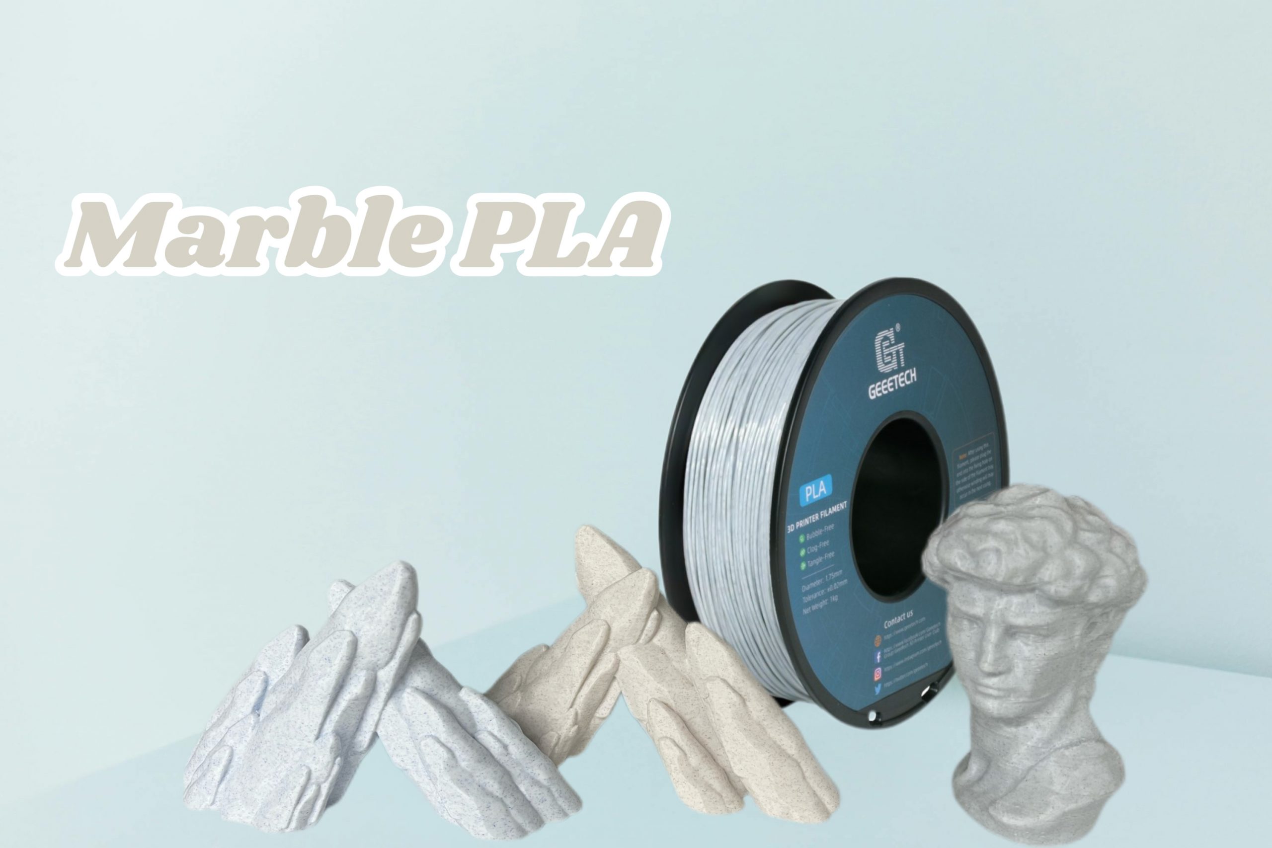

If you have ever used your 3D printer to produce busts, full sculptures, model buildings and so forth, you might have wondered how to get even better results than typical PLA can offer. This is where Marble PLA filament comes in, as it has some unique properties that make it perfect for imitating the look of real marble, thus enhancing your designs significantly.
What Is Marble PLA?
As the name suggests, the PLA filament itself is made out of PLA, but where the magic happens is with the addition of fine marble powder, which is essentially crushed real marble stones. This produces a unique look and results in a stone filament.

This unique stone PLA filament is typically used in designs where there is a decorative element involved, since it produces a realistic-looking marble texture and effect. Therefore it is especially useful for statues and busts, where you can recreate famous sculptures and art pieces that have been digitally scanned and made available, to create your own mini museum.
Alternatively, you can use it for architectural models and miniatures that also benefit greatly from the unique texture. As seen in the images below, the details and fidelity that regular PLA offers are still visible with marble filament, allowing for highly detailed prints that work great no matter the size of your print.
