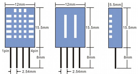

Each DHT11 sensors features that extremely accurate calibration of humidity calibration chamber. The calibration coefficients stored in the OTP program memory, internal sensors detect signals in the process, and we should call these calibration coefficients. The single-wire serial interface system is integrated to become quick and easy. Small size, low power, signal transmission distance up to 20 meters, makes it a variety of applications and even the most demanding applications. The product is 4-pin single row pin package. Convenient connection, special packages can be provided according to users need.
Dimensions
