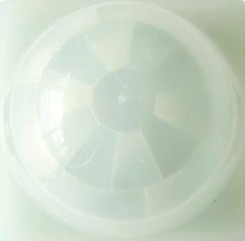

IR energy is delivered to the Pyroelectric Sensor by means of a mirror-like reflector or through a lens. When a mirror is used, each of the facets of the reflector views a certain area (field of view) and bounces the IR energy it receives onto the Pyroelectric Sensor within the detector. In the case of the Lens, its segments overlook the protected area and similarly pass the IR energy on to the sensor directly behind it.
