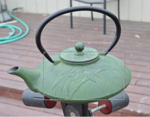

Shapespeare offers more scanning advice in Step 9, where he explains that the object should be still when you shoot it, not too shiny, and not too big or too small. Make sure it has a lot of surface detail with no large uniform areas, and it shouldn’t have any thin delicate parts, either. Step 10 covers setting up for a photo shoot. If you place the object you’d like to scan on a stool, it will be easier to photograph. Also, make sure that there’s good, diffuse and even lighting and remember that a camera flash may not be of much service here. It is required that you take about 100 photos, so you’ll want to make sure you are comfortable as well.
In Step 11, shapespeare covers how to set up your camera, and then we finally arrive at the important tips on how to take your actual photos in Step 12. (The better the photos, the better the scans.) He explains that you’ll need to move around the object to capture its 3D shape, and he recommends overlapping many of the photos:
“After you shoot the first picture look carefully at how it is framed. The object is to overlap adjacent exposures by 50-60%. When in doubt, overlap more. If you think you may have moved too much, go back halfway and shoot another picture. The order of the pictures doesn’t matter to most software. Remember that you can always dump extra shots, but you can’t make up for shots you didn’t take. Once you break down your set up you are done. If you find later that you need more shots you usually have to start again from the beginning.”
“The Parallax Trick” refers to shooting the object in a way that magnifies your perception of motion. When you move in between shots, the background of the object changes, so it is recommended that you watch the edges of the subject to stay aware of how the background changes. Other photo shooting tipsinclude having too many instead of too few photos of your object, and picking your camera angles to get as much coverage of the object as possible. You also want to keep an eye on your exposure settings and remember that a little overexposed works better than underexposed.
