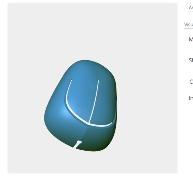

Step 4: Showtime: Output model from designer
I finally received the a model from the designer on ProtoDnD and this is what it looked like. What is shown above is the final output from the designer. When the designer uploaded a first version of the model, i realized it might be useful to have a hole for bringing out the debug and programming interface for the micro-controller on-board. I conveyed this to the designer by annotating the STL model directly on ProtoDnD’s web interface as seen in the 4th image.
