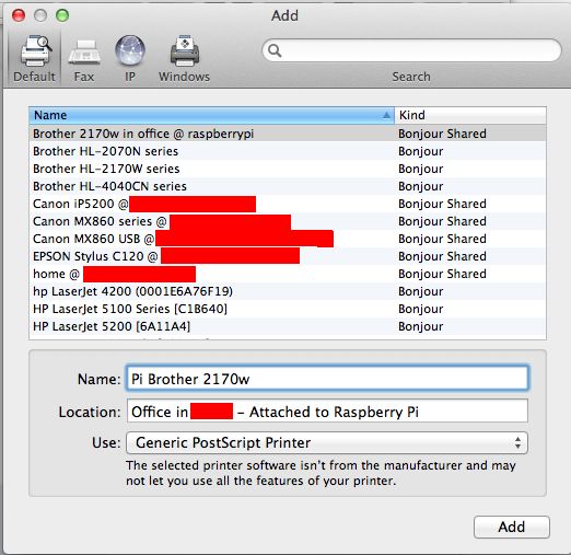

Your PiPrinter should be showing up from any other machine on the network as if it were a shared printer. (Note the @RaspberryPi)
Rename it and give it a location if you want! Use “Generic Postscript printer” on your connected machines since CUPS on the Pi is handling the printer-computer driver relations.
