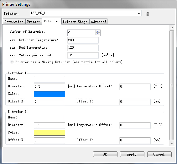

Step 2: Set up your extruder
- Choose the number of extruder, here we choose 2.
- Set up the diameter and color of filament
- Offset X/Y refers to the distance between the two extruders,which can be adjusted based on real situations. You can leave it alone now.
