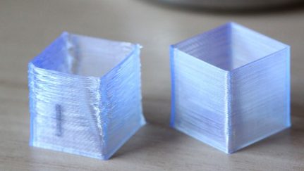

While printing your 3D model, you see that the print curls upwards especially along the edges until it’s no longer level with the print platform. It can also lead to horizontal cracks in upper parts and cause your print to lose adhesion from the print bed.
Why does it happen?
Warping is a common phenomenon caused when the printed plastic parts at different areas of the object begin to cool at different rates. As the ABS or PLA filament cools it starts to contract very slightly and thus the problem of warping arises if the plastic is cooled too quickly. Though PLA has a much lower shrinkage factor than ABS, both can warp and curl, potentially ruining a print. Here are some tips that you can try.
