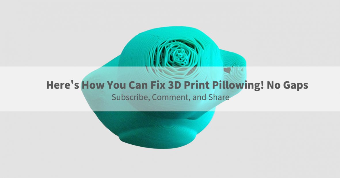

Your 3d print may have seemed successful while printing it but once it’s finished you notice gaps and holes in the outer layers. This is known as pillowing and though it is frustrating after spending hours on a print, there are some easy ways to prevent it from happening again! How to fix pillowing here we go!
Why does pillowing happen?
There are several reasons why these gaps and holes form on the 3d print. If the print’s top layer itself isn’t thick enough then pillowing is more common as well as if there isn’t sufficient cooling of layers.
Luckily with a few adjustments and changes in your print settings, you can avoid it from occurring again.
