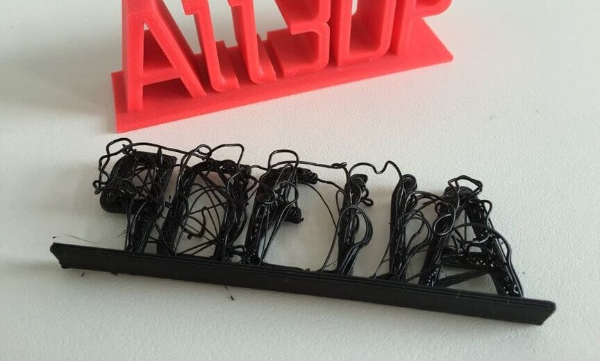

Fused Filament Fabrication Frustrations? Read our 3D printing troubleshooting guide to the most common 3D printing problems and their solutions.
It’s amazing what your 3D printer can produce. But we’ve all had those infuriating moments when, despite everything, a seemingly simple model just refuses to print successfully.
You’ve checked the model, and seen countless others make it without issue, but try as you might it just won’t print. What is it that keeps going wrong?
Here at ALL3DP, we’ve had our fair share of print failures. But the upside to those failures is that we’ve become finely tuned to recognizing and solving many common 3D printing problems.
Direct from our 3D printer troubleshooting experience, we’ve collected together 24 of the most common 3D printing problems and replicated them here.
This article will help you to quickly diagnose your 3D printing issues, and find the solution with our 3D printer troubleshooting guide. Discover how and when these 3D printing problems occur, and the steps you can take to avoid them in the future.
