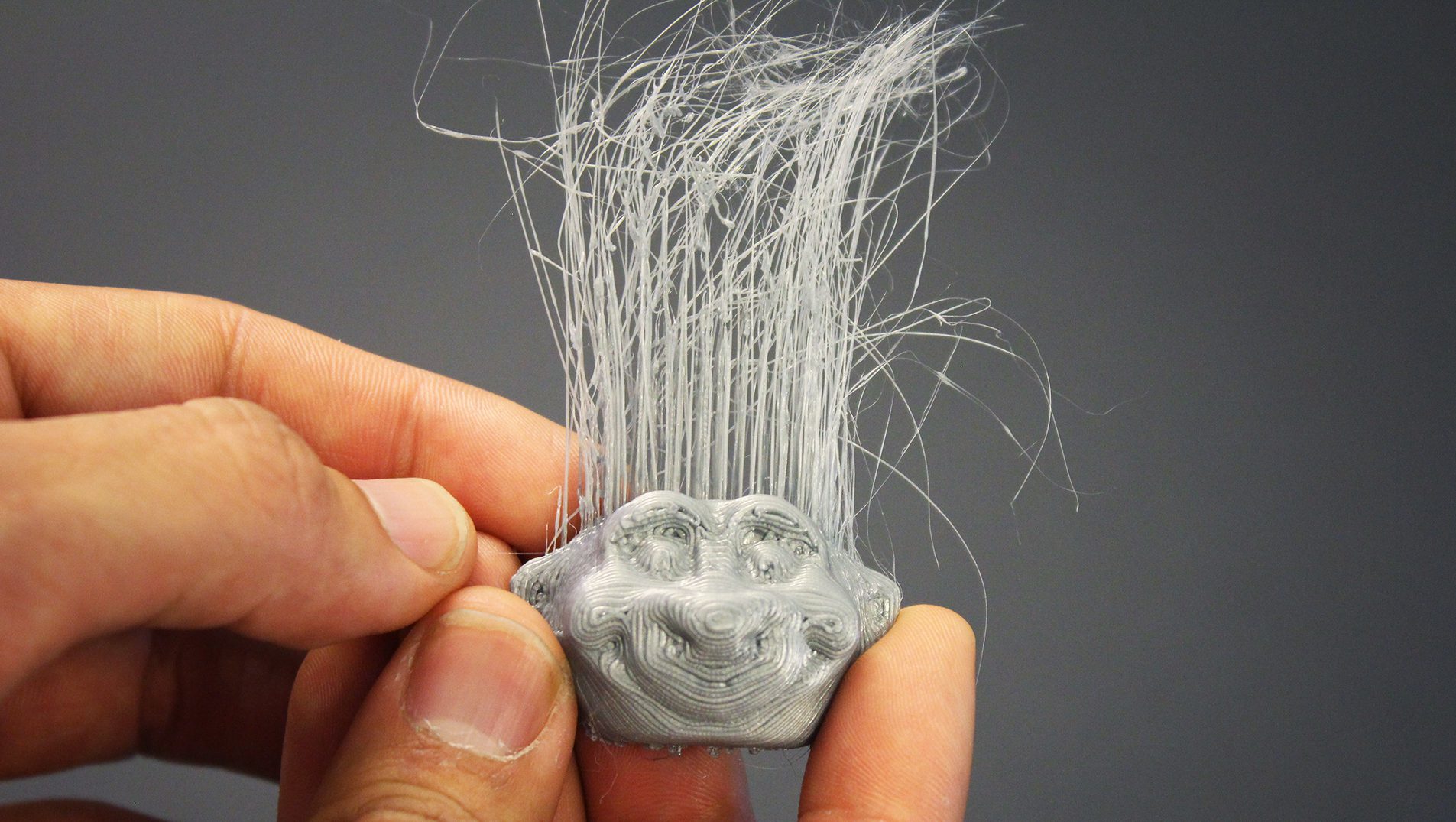

Your 3D prints have thin strands of filaments in places that should be empty usually where the print head travels from one printing point to another. This problem is known as ‘stringing’.
Why does it happen?
3D printing stringing or oozing takes place when small strings of plastic are left behind on a 3D-printed model. It mostly occurs when melted plastic oozes out of the nozzle while the extruder is moving to a new location. When the nozzle moves over an open area, some filament has dripped out. It then solidifies with the movement of the nozzle and the “strings” are formed.
