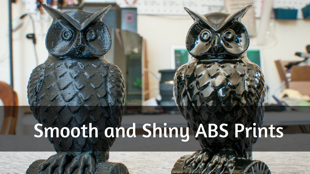

Finishing your 3D prints is just as important as actually printing them out carefully. We all want the end result to be smooth and polished but the surface finish of even the nicest prints is covered in tiny ridges. This is simply due to the way the printer works, building layer by layer on top of each other.
If you’re working with ABS then you’ve probably come across the acetone vapor method or heard about it. This guide is here to help you know a little more about this method and even try it out for yourself.
Smooth and shiny prints are on their way!
