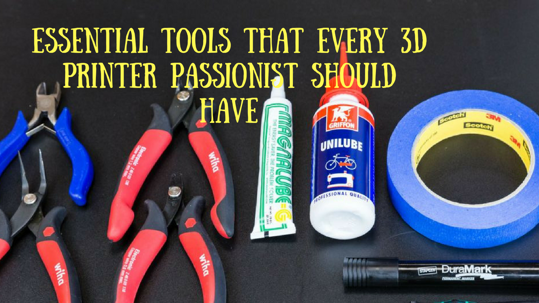

Magnalube and Unilube
Sometimes the X and Y axles need to be lubricated to ensure that they run smoothly.The best lubricant to use is Unilube, and all it takes is a single drop to resolve any issues with dryness. For the Z trapezoidal leadscrew, use Magnalube.
It’s important not to use WD40, as this affects the axle coating and can cause damage to your printer.
Masking tape
The most widely used surface covering for print bed is the masking tapes it allows the prints to adhere better.Additionally, the tape also makes removing the finished print easier and it protects your print bed from scratches.
When buying the tape, make sure to select a width of at least 50 mm (2 inches). Wider tape requires fewer strips to cover your print bed, something you will come to appreciate if you resurface your print bed frequently.
Choosing a proper masking tape of depends on your preferences and build size. If you regularly print to the full width of the bed, it might make sense to get the wider sheets.
