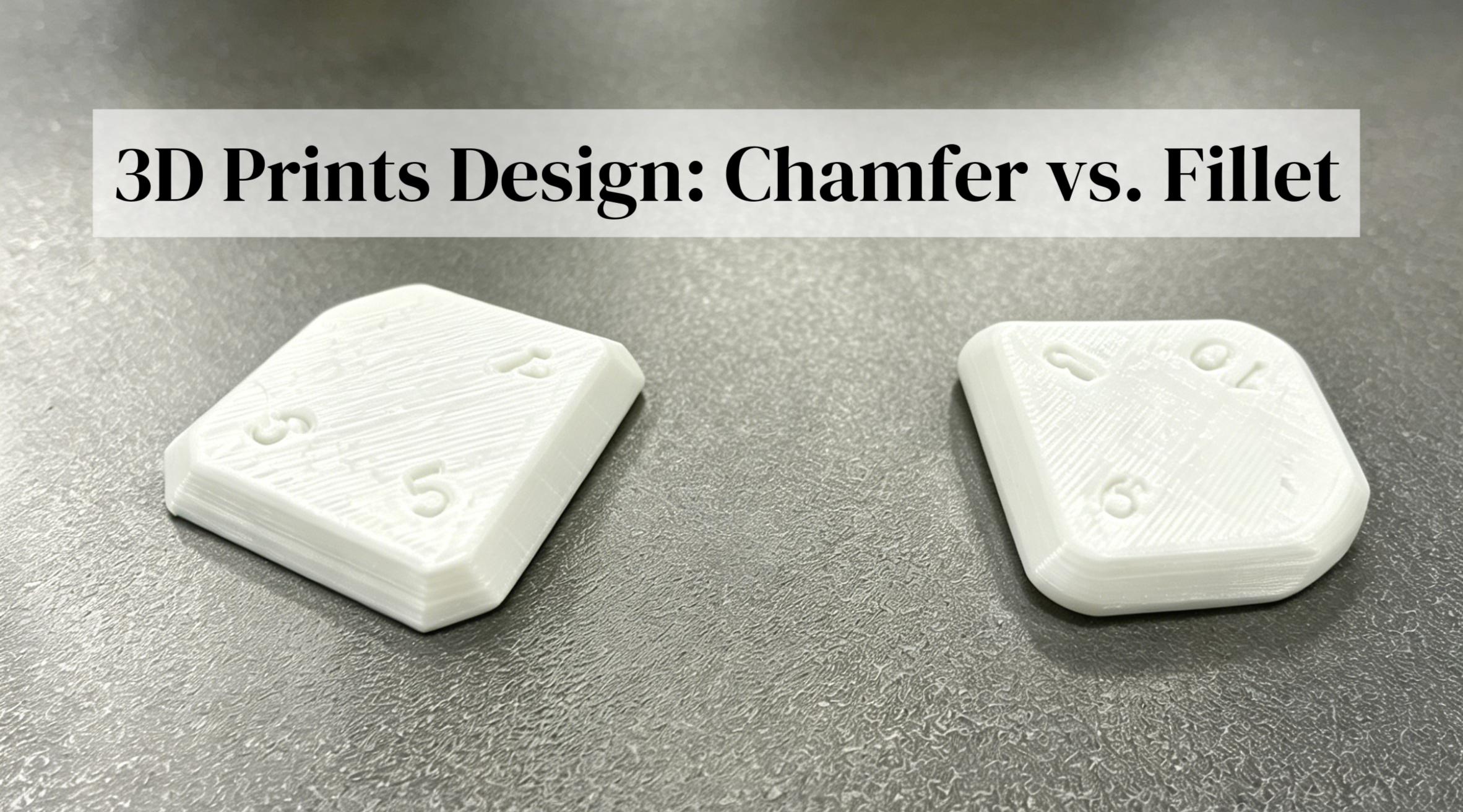

What Is a Chamfer?
A chamfer is a transitional edge that is angled, typically 45°, connecting two surfaces. It is essentially a “beveled” or “cut-off” corner. The chamfer replaces a sharp horizontal overhang with a sloped ramp.
What Is a Fillet?
A fillet is a rounded transition, whether concave interior or convex exterior, connecting two surfaces. It follows a radius, where the fillet creates a smooth, curved surface. An outer fillet that rounds the outside corner may create a severe overhang. An internal fillet that rounds the inside corner helps strengthen the joint.

Chamfer
A chamfer is generally easier to print and model, but it provides less stress relief than a fillet, especially on chamfered edges, for instance.

Fillet
A fillet excels at eliminating stress concentrations and improving strength, but it can create difficult-to-print overhangs on external bottom edges.

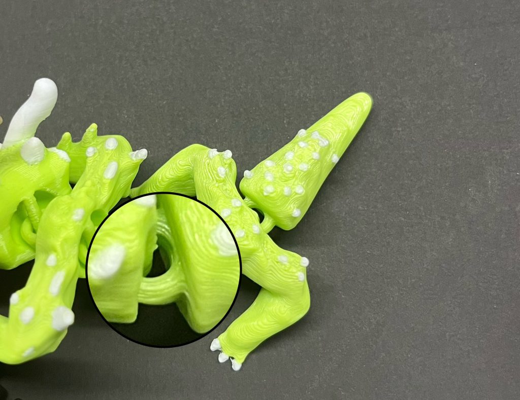

- If structural strength is critical, Internal fillets, where a vertical wall meets a horizontal floor, dramatically increase layer adhesion and prevent part splitting.
- When load is cyclic or bending, a fillet line helps eliminate sharp internal corners that act as “stress risers.” Example: a bracket or a lever.
- If appearance matters for consumer products, ergonomic grips and organic shapes look better with fillets.
- When you can print the fillet vertically or on top, as top fillets print perfectly, internal fillets print well because they are supported by previous layers.
